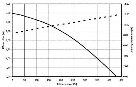

Pumps have one curve that is of major importance, the pressure versus flow curve (P-Q). This give the flow rate through a system for any backpressure produced by the loop. This curve of the LAING/DELPHI DDC from the LAING website shows power consumption versus flow too. Note that power consumption increases as flow increases. Also note that pumps do produce heat. This should be considered very carefully if you plan to fork out for a powerfull and expensive pump - it could provide worse system performance if your radiator is not up to scratch. Examination of the graph shows that it has a maximum flow of about 430L/H and max head of 4MH2O. If you can make your self a restriction curve for your system (an exceedingly difficult task to do properly), you can place it on the same graph, where the lines cross will give you your theoretical flowrate. P-Q curve for the Laing/Delpi DDC
