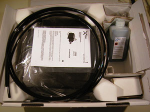

The box itself is fairly large at 460x380x160mm and when opened it can be seen that the ExternalCool unit itself takes up most of the room. The ExternalCool unit, as the name suggests, is designed to be positioned outside the computer case and is the heat exchanger or radiator component. The solid cardboard box and foam corner pieces enclose the ExternalCool unit and protect it well during transit. Unfortunately our bottle of Xice fluid developed a leak during transit, apparently because the cap was over-tightened, so some of the fluid leaked into the box. Luckily, while this did result in some wet and mouldy smelling cardboard, there was no other damage.

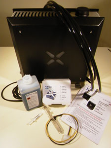

The content of the Xice ExternalCool kit – with only a handful of components – really outlines the 'keep it simple' principle. The highlight of the kit is the large black ExternalCool unit itself. Also included is the Xice xpk (more commonly known as a waterblock), tubing, coolant fluid, a PCI backing plate with a power connector, a bunch of instruction booklets and some thermal paste. The included thermal paste is actually Arctic Silver Ceramique, which is a nice touch. Xice supply the ExternalCool kit with either an AMD or Intel xpk, and while the waterblock is the same in both cases the side clip's mounting mechanism is different.
Our review unit, the Xice ExternalCool EC900 Off-Center 'Clip', contains two main components, the ExternalCool unit and the waterblock. The 'EC900' designation indicates that our kit contains a 12 Volt pump that is powered via the PC power supply. Xice also provide a range of 'EC600/H' kits that have 230 Volt/50 Hz pumps that are powered by a wall-socket (presumably with European style plugs).
