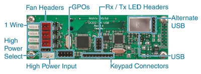

I thought a little more detail on the rear connectors might be useful. These add a whole new dimension to the use of this product, instead of using it as a fairly passive display. Here's a picture from the manual:
Click to Enlarge
"Fan Headers" is obvious, providing up to 1000mA to power fans at +12v or +5v, and reporting the fan speed at +12v (but not at +5v). "High Power Input" is the floppy-power connector that can optionally run the screen and provide power to the fan headers. "High Power Select" is a jumper that chooses +5v or +12v for the fan headers. "Keypad Connectors" is already connected in this unit (as the MX610 is essentially just Matrix Orbital's PK202-24_USB screen connected to a keypad and bay frame). "USB" is where the main cable goes while "Alternate USB" is for the optional internal USB cable.
So, that leaves "1 Wire", "GPOs" and "Rx / Tx LED Headers" unexplained. The "Rx / Tx LED Headers" are for optional LEDs to give a visual indication of data being transferred. "GPOs" are "General Power Outlets", and are similar to the Fan Headers, but only provide +5v at 20mA. With these you can drive LEDs or even control relays, again, in response to various events.
"1 Wire" refers to the "Dallas 1-Wire" specification. In this instance they're used to connect the optional temperature sensors. However, a Google search reveals that this specification is a widely-used home automation standard which has much more capability than simply monitoring temperature diodes. From looking around the forums and the on-CD product manual, it seems the MX610 is fully capable of talking to and controlling all 1-Wire devices. When coupled with the GPOs and fan connectors it seems you could use the MX610 to control quite a few other devices in response to various events. I got rapidly out of my depth when looking around at that stuff though, so if you want to explore what it can and can't do, you'll have to do your own homework - I recommend MO's forums as a starting point.
