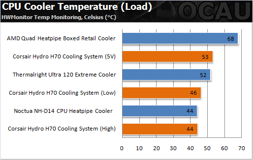

For today's tests we'll be using AMD's Phenom II X6 Black Edition which will be overclocked to 4.0GHz at 1.45v. Each cooler will be load tested with LinX for a period of 20 minutes, idle temperatures will be taken over a period of 20 minutes as well, with the lowest and highest temperatures being recorded.
The ambient temperatures are monitored throughout the testing, and while we maintain a 25 degree temperature in the room, eagle-eyed readers may notice CPU temperatures below that being reported. This is because we are using the on-die thermal sensor in the CPU to report temperatures, which seems to be a little optimistic in its reports. However, the same motherboard and CPU are used for every test so the temperature difference between each test is accurate for the purposes of comparison.
The coolers in today's comparison will include AMD's retail quad heat-pipe cooler, Thermalright's Ultra 120 Extreme with Thermalright TR-FDB-1600 63.7 CFM fan and Noctua's monster NH-D14 from our previous review here. Each cooler's fan(s) are connected directly to a 12V 3pin to Molex converter unless stated otherwise. The thermal compound used for each test is Noctua's NT-H1 that does not require 'burn-in' time for optimal performance. This includes the Hydro results, where we didn't use pre-applied compound. Instead, the Noctua thermal compound was used for all the benchmarks so temperatures are more consistent. For the general user, the stock compound is perfectly sufficient.
For Corsair's Hydro H70 cooling system, we have included three sets of results highlighted in orange. They are as follows:
  • High = Fans full speed, no restrictions, running at ~1945 RPM
  • Low = Limited, utilising the included adapters to step down the RPM to ~1642 RPM
  • 5V = Using our own 3pin adapter to further decrease RPM (not included in package)
Noise measurements were taken with a digital sound meter approximately 5cm away from the heat-sink fan(s), reducing the ability of other components such as power supply fans or other environmental noises to interfere with the final results on the open test-bench. Due to the Corsair Hydro H70 having a pump and fans in separate locations, we focused our attention to the fans for these results, as the pump was silent compared to the fans.

A quick look around shows the H70 costing about $150, which places it above high-end air-coolers like Noctua's NH-D14, but well below the cost of a custom watercooled setup. In terms of cooling performance and noise level it's in the same ball-park as a high-end air cooler, but there are some clear advantages to a small pre-assembled watercooler like this - not the least of which is that, instead of having a large heatsink blowing hot air around your system, the radiator fans blow that heat immediately out of the case.
