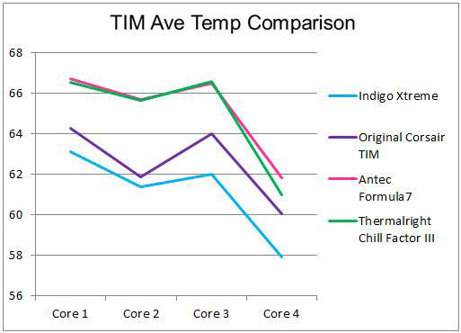

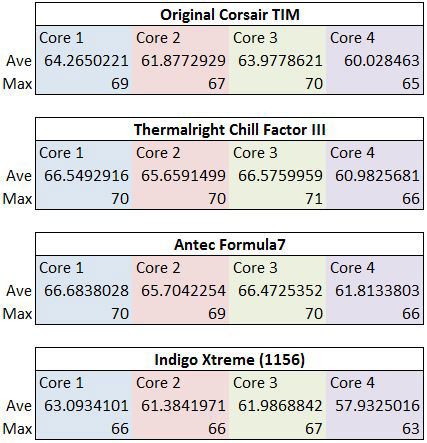

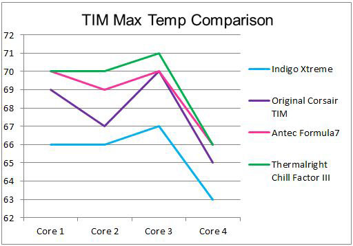

As you can see in the table below, the TIM Corsair/Asetek provide on the H70 performs extremely well. Corsair have confirmed that they use a very high quality Shin-Etsu paste, which is certainly consistent with my results. Average temps were closer to the Indigo Xtreme than the other two pastes.
The Chill Factor III and Formula 7 are very close in performance, so much so I'd call them interchangeable for all intents and purposes. Both are certainly serviceable, but the manufacturer supplied paste on the H70 is of higher quality.
The Indigo Xtreme has performed admirably, with peak temps up to 4°C lower than the Chill Factor III and Formula 7 and even up to 4.5° difference in average temps. The difference in average temps in comparison to the Corsair supplied TIM isn't as substantial, but peak temps were down two to three degrees, which is some improvement if not ground-breaking.
TIM Performance Summary:
It appears that when correctly installed and 'primed' the Indigo Xtreme can indeed offer unsurpassed TIM performance. However, that performance improvement is only two or three degrees Celsius over a high-quality paste, and it comes at a price - at between $20 and $30 (depending where you buy it) for an installation pack, you only get two Xtreme TIMs, so each one is really worth $10 to $15. A tube of high quality thermal paste will set you back about as much as just one Indigo Xtreme TIM, but you will easily get at least 10 applications out of the paste, so the Indigo Xtreme doesn't make sense on the dollar-per-performance scale.

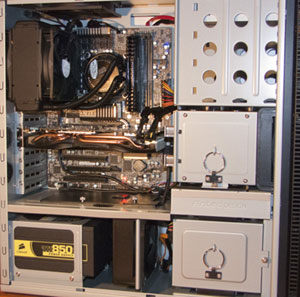

installed, before fan re-orienting
In this build, I wanted to mount the radiator at the lower front of the case, leaving the existing top and rear exhaust fans in place. Unfortunately that's impossible with the existing tube length, so I've had to go with a sub-optimal rear mount. The one upside would have been positive case pressure, but that would have been mitigated by a substantial portion of that air being quite warm by the time it was inside (and not dust filtered, anyway). The final assembled PC turned out to be overheating the graphics card, as at least half of the GTX560Ti SOC's heat is distributed straight into the rest of the case. So the only solution was to reassemble with the H70 fans blowing out, and thus the CPU running a little hotter - but the difference was only a few °C and didn't affect stability. So, pretty please Corsair/Asetek, give us some longer tubing?
