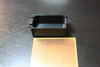

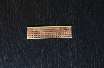

Cut the breadboard to size. Note that in each of the progress pictures here that the traces run horizontally, NOT vertically. Make the size of the breadboard wide enough to fit the box and cut it with either a saw or a dremel. A saw’s best suited for this job, really.

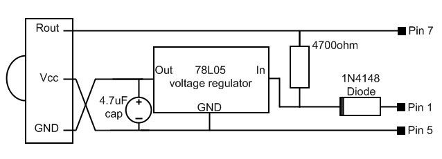

From here it’s a matter of soldering the components to the board, according to this schematic:
The schematic is actually based on a schematic on the lirc.org website. I should also note that there's a crossover on the left – the wires are not joined there.

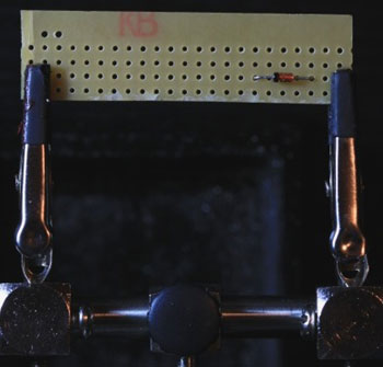

So, start by soldering the diode in place. Note the polarity (black strip on the middle instead of the edge):
Click to Enlarge

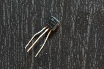

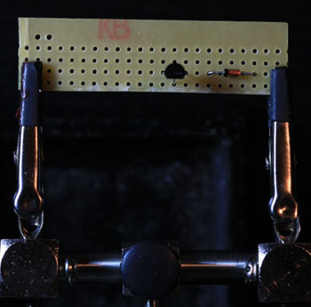

With the voltage regulator, splay the legs of it so that with its writing towards you, push the side legs to each side a little, and pull the centre leg so it’s towards you.
Click to Enlarge
Place the voltage regulator as such:
Click to Enlarge

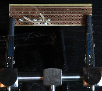

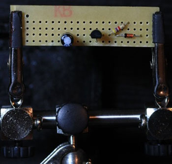

Then cut the traces below the diode and voltage regulator so that one pin of a component is not connected to another by the board’s traces. I used a dremel for this – I really shouldn’t have used a cutting disc though:
Click to Enlarge
Then the easy stuff – add the resistor:
Click to Enlarge

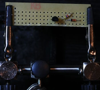

Then solder the capacitor with the side containing the white strip (negative pole) on the bottom:
Click to Enlarge

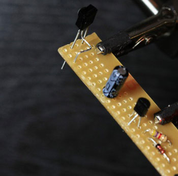

The IR diode needs its legs bent in a particular way, as the diode from Jaycar has a different pinout to the one in the lirc.org schematic. Note the way in which I’ve bent the pins, and also what other components the pins line up with:
Click to Enlarge

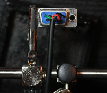

The diode is to be mounted offset on the edge of the circuit board so that the diode is as exposed as possible inside the jiffy box. Cut or drill a hole for the diode as appropriate. With your multicore wire, strip and tin the ends of three of the wires, and solder them to the circuit board as per the schematic on the locations DCD, Vcc and GND. On the other end of this cable, slide on the backshell (important!) Then strip, tin and solder the wires to the appropriate ports on the female DB9 solder connector.
Click to Enlarge
Solder DCD to pin 1, GND to pin 5 and Vcc to pin 7. Before you go any further, make sure everything is soldered correctly, that you have the correct polarity on the capacitor, and the correct polarity on the diode. Double check all of your connections, attach the backshell and plug it in. Also make sure you have your serial port enabled in the BIOS.
