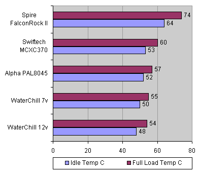

To test a "full load" temperature we ran the POVRAY benchmark for 15 minutes. This is a raytracing program which locks the CPU at 100%. Just in case any idle CPU cycles slipped by, we also ran the Folding@Home client in a DOS window. After 15 minutes the temperature was recorded - all heatsinks stabilised in less than 10 minutes anyway during testing. For our idle temperature, POVRAY and F@H were closed and the system allowed to cool itself down for a further 15 minutes before the temperature was recorded. The ambient temperature was 25C and we used the onboard thermal sensor to monitor the temperature.
Bear in mind that the temperatures reported may be inaccurate and shouldn't be compared to other motherboards. We are mostly interested in the difference between the aircoolers and the WaterChill unit rather than the absolute temperatures reported.
From our results we can see the WaterChill handily beat even the much louder heatsinks from Alpha and Swiftech. The quieter option from Spire fared quite badly - it seems our overclocked and overvolted CPU was simply too much for it with the stock fan. 74C is much higher than I'd be comfortable running this CPU in the long term. It's common to see these Spire coolers with more powerful fans on them and they perform impressively with more airflow, but of course there is then more noise being produced. You will note there is only a few degrees difference between the Alpha cooler and the WaterChill, but the noise difference, especially for the WaterChill in 7v mode, is dramatic. While the WaterChill is almost silent, the Alpha's 80mm Sunon fan emits a constant low-pitched whoosh which, while not as annoying as a 60mm Delta screamer fan, is still above the level I would consider comfortable for long-term use - and it's still running 2 degrees hotter than the WaterChill.
Interestingly, there's not much difference between 12v and 7v mode with the WaterChill. Unless you are really pushing the limits with an even hotter-running CPU than our testbed, it seems unlikely you'd ever need to switch the WaterChill to the noisier 12v mode. This kind of performance from a system that is almost silent is very impressive. It will be interesting to see how the system scales with an even faster and hotter CPU, to see if the difference between the air-coolers and the WaterChill increases. I would expect the aircoolers to hit their limit before the WaterChill, but we'll have to see when the new CPU block lid arrives.
