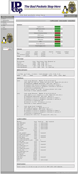

So far, so good. Once installed, IPCop is controlled via a web interface from another PC on the network. Connecting to the web interface shows the configuration and resource usage.
Click to Enlarge
The CL6000E packs way more than enough punch to run IPCop. A 600MHz processor, 512MB of memory and a 30GB hard drive are well and truly overkill. This motherboard will definitely not be stressed running in its intended role. It will have an easy and happy life.
In summary, installing and running IPCop on the CL6000E was as simple as I could have hoped for.
