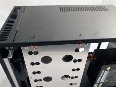

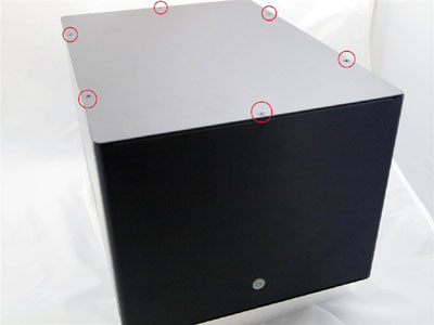

Let’s start building. Get your Fractal Design case and remove the top 6 screws as shown below:

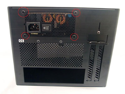

Remove the power supply by undoing the 4 screws on the back:

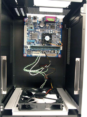

Install the motherboard IO plate in the hole on the back of the case; now screw the motherboard down to the mounts of the case:

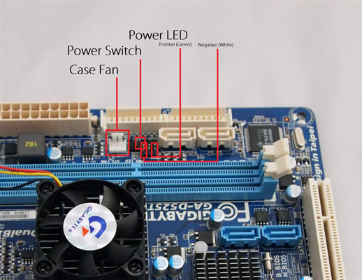

While we are in here with all this open, plug the power switch, led and fan in. Here is a diagram of where it all goes.
Click to Enlarge

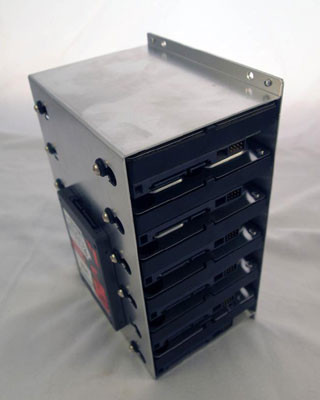

Click to Enlarge
If you have an SSD you wish to use, install this first on the bottom of the caddy. In my case I have six drives but if you only have four, fill up the centre four spaces in the caddy. This will ensure good airflow over the four drives. Install a molex to SATA power connector to the SSD, and plug in the SATA cable for the SSD. The molex to SATA power adapter is needed to help the power supply reach the SSD and all hard drives.

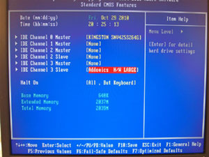

When the PC boots you can enter the bios and you should see the Addonics device showing as a single drive - if not, you might want to recheck the cable connections. I won’t go into the extreme details of installing Windows; just pop the Vista CD in the drive and let it boot and install by following the bouncing ball. Once installed just load up any drivers needed - I let Windows find the correct drivers online.

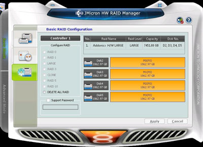

First thing I install the JMB393 RAID manager to allow me to configure the RAID. You can find this application on the CD shipped with the device but I find it’s easier to download it off the Addonics website. Once installed open the software and click on the bottom button on the left that will allow you access to the RAID config.
Click to Enlarge
If the device has automatically created a RAID array select “DELETE ALL RAID” then recreate the raid setup you want; in my case I want a RAID5. Once created you can open Device manager by hitting the windows key + pause/break, select disk management and follow the onscreen popup up to initialise the drive as GPT partition. Right click on the unallocated space and choose “New Simple Volume”. Follow the wizard changing what you want (quick format if you don’t want to wait for hours) and once it is finished your drive is created and presented.

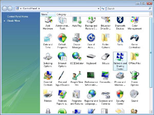

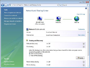

So open control panel in classic view and open the “Network and Sharing Centre”.
Click to Enlarge
Click the down arrow on “File sharing” and select the radio button “Turn on file sharing” and “Apply”. I am not worried about network security inside my home - if you are you can ignore this step, but you will need to make a new user for each user to login to access file shares. Click the down arrow next to “Password protected sharing” and select the radio button to turn password protected sharing off and Apply. Re-open Control panel and hit the ALT key. Choose Tools -> Folder options

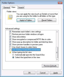

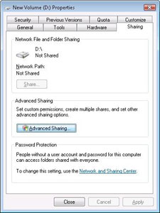

Click the “View” tab. Scroll down to the bottom and de-select “Use Sharing Wizard”, click apply. Now we’re on the home stretch. Right click on the drive or a folder under the drive and select “share”.
Click to Enlarge

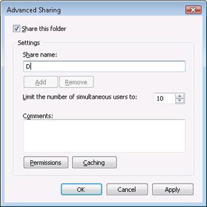

Select “Advanced Sharing”
Click to Enlarge

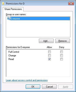

Tick the tick box “share this folder”. Give the share a name, then click “Permissions”. As I have previously said I’m not too worried about security on my internal home network so I will be granting “Everybody” access to the server, but if you created individual user account this is where you would put them.
Click to Enlarge
Click on “Everyone” and click the Tick box to the right of “Full Control” and below “Allow”. Click Ok, Ok. The folder should now be shared. Hopefully you know what you named the new server. If you don’t, right click on “Computer” and select properties. There you should see the computer name. If it is something you will never remember click Change Settings and change it.
