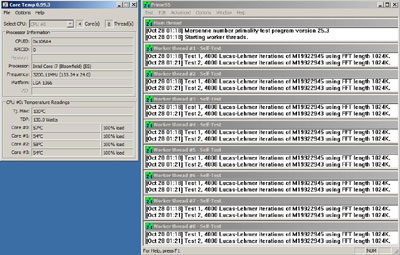

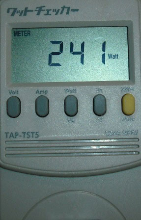

Intel is rating the Core i7 920/940/965 with a thermal design power (TDP) of 130 Watt and a maximum case temperature of 55C. The QX9770 is rated at 132 Watt and 55.5C. Going by these values, power consumption and heat dissipation should not be much different. On the other hand, Core i7 processes more instructions per clock cycle than Penryn, and better performance comes normally on the expense of higher power consumption. However, we found that Core i7 is doing quite well in this regard. The wattage monitoring unit we used reads power consumption at the wall plug. The values shown in the “System Power” chart represent therefore total system consumption, including video card, chipset, RAM, and peripherals. When idling, the i7 920 system consumes 132 Watt. The i7 965 system consumes 137 Watt, 4.5 % more than the QX9770 system. To simulate maximum processor load we did run 8 instances of Prime95. The i7 965 consumes 241 Watt. This is again around 4% more than the QX9770 under the same condition. The temperature of the 4 x i7 965 cores was between 54C and 58C when Prime96 was running. These are very acceptable values both for the wattage and the heat dissipation considering that Core i7 is running most applications much faster than Penryn.

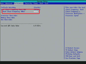

The frequency of the CPU can also be set by increasing the base clock and leaving the multipliers constant. From the Performance setup page set the ‘Host Clock Frequency Override’ setting to ‘Manual’. This allows increasing the Host Clock Frequency (MHz). The following BIOS screenshot shows the setting for a “Core i7 965”. The default multiplier of 25x and a Host Clock Frequency of 155 MHz are resulting in a processor frequency of 3.88 GHz

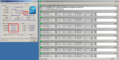

Penryn’s excellent overclocking potential is credited to Intel’s high yielding 45nm production technology with low current leakage and the usage of advanced materials as explained in our Penryn review. Core i7 is produced with the same technology and should overclock therefore not worse than Penryn. At least that is what our results were telling us. The Core i7 965 is an Extreme Edition and that means we could change the processor multiplier. This keeps all other system components stress free when overclocking. After the usual procedure with trying various BIOS settings we settled at 32x133.3=4260 MHz. This is with air-cooling and 1.55 core voltage.
The result with the much more affordable Core i7 920 is probably of greater interest for you. As this processor is “multiplier locked”, it can only be overclocked by increasing the QPI frequency. With the help of additional voltage the 920 would run at 20 x 185.5 MHz QPI=3720 MHz. However because the i7 920 continued to run in “Turbo Mode”, the actual frequency was 22 x 185.5 = 4081 MHz. The i7 920 would run Prime95 for 1 hour with these settings. 4081 MHz is 53% above default and quite an amazing result. We want to hold back though with far reaching assumptions here, because both processors are engineering samples. They might have been “hand-picked by Intel for their high frequency headroom. It has to be seen how retail processor overclock, but Nehalem looks promising.
