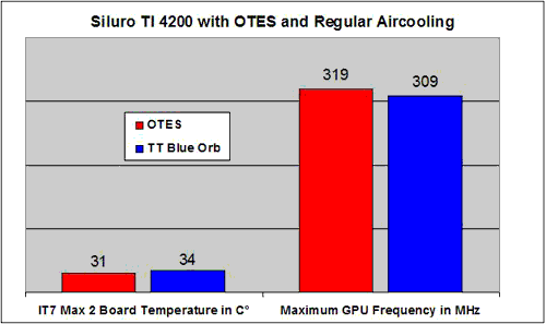

How to find out that these claims are true? To compare our Siluro OTES sample with another, non-OTES TI 4200 does not make much sense, because the impact of OTES on the GPU’s overclocking headroom can easily be exceeded by the usual differences between GPU samples itself. Instead we conducted a little experiment: we removed the OTES cooling unit and replaced it with ThermalTake’s Blue Orb VGA cooler. The Blue Orb with a high profile 5,500 rpm fan is at least as efficient as the cooling solutions on regular TI 4200 video cards. The Blue Orb’s conventional 2 pin fastening does not fit with the heavy-duty OTES 4 bolt fastening design. We removed the 2 pins and glued the Blue Orb with Arctic Silver epoxy to the GPU. We then checked the mainboard temperature and the overclocking headroom of the GPU when cooled by OTES and compared it with the Blue Orb results. In order simulate a gaming environment we kept one of the UT II 2003 time demos running for 1 hour (instead of the usual 77 seconds) before we took the IT7 Max 2 board temperature with the Winbond monitoring utility. We disabled all case fans to make the heat build up in the case better visible.
Click to Enlarge
No question: OTES works! A 3 C° lower mainboard temperature and 10 MHz better overclocking headroom for the GPU are not earth shattering, but progress comes in small steps. One might also point out that some TI4200 with conventionally air-cooling can be overclocked even higher than the 319 MHz we achieved. 20. But these lucky samples, which got far above average running GPU would overclock even better with an OTES like cooling system. We were using a roomy Lain Li PC 70 aluminum server case. We think that the temperature lowering OTES impact on board and case would be even better when using a cramped desktop or mid tower case. We also think that the OTES cooling impact is closer to a much more complicated and potentially dangerous water-cooling set-up. As a side note: although enclosed, the OTES fan is really noisy. But it is free from vibrations thanks to the two ball bearing design and the firm fastening with 4 bolts held by the support shield on the back of the card.
