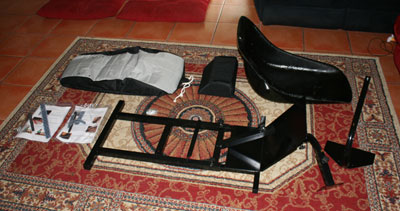

Once all the goodies have been removed from the box we get a clearer picture of how things will shape up. Starting at top right and going clockwise we have the black fibreglass seat, the wheel mount, the shifter mount, the metal base, two packets of instructions, the seat lining and a foam footrest block. The instruction packets include some screws, washers and nuts, as well as some sticky velcro strips.
The instructions unfortunately leave quite a lot to be desired. They've been updated to say that they refer to the old red version of the VRC, not this newer black version, but simply stating that doesn't make them any more useful when assembling the black VRC. For example, one of the first instructions is to expand the base from the compacted shipping position into a more comfortable seating position, by sitting in the seat and pushing the footrest away with your legs. But this black version does not have the seat mounted yet, and there's no mention at all of how to mount the seat in the instructions - not even which bolts or nuts to use. If you're reasonably handy with tools you can figure this kind of thing out, but it's needlessly confusing.

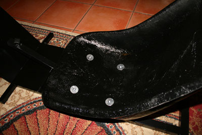

Having owned a Rotax kart with a fibreglass seat I was able to figure out what I assume is the correct mounting, using the provided large metal washers to stop the bolt heads tearing through the fibreglass:

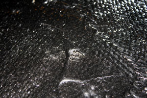

It's worth taking a moment to check the finish of the fibreglass seat - it seems a little scruffy, but nothing that will affect it in use.
