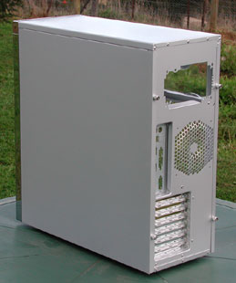

At the back there's a 120mm fan mount, with the honeycomb mesh raised away from the fan blades to help reduce noise. Removing the motherboard-side panel is a little tricky when you first approach it. It's obvious that the two thumbscrews on the back of the case should be removed, but the panel stays firmly in place. Only when you have removed the front of the case are another two thumbscrews revealed. If you're like me and expect to have to remove both side panels to get the case front off, you end up in a frustrating little conundrum for a while. Of course, given that this case has a removable motherboard tray and uses drive rails, most people will never remove the motherboard-side panel.
Antec continue their trend of mounting hard drives sideways across the case - I note that other manufacturers are doing that now too. The side panel is secured by two large twist-latches, one of which can be locked with the usual round key. Once you turn the latches, you pull the top of the panel straight towards you, then up and off. This again is different to how most people will be used to so it's tricky at first, but no problem once you figure it out.
The removable motherboard tray is secured with a single thumbscrew. Unusually, the tray lifts out of the side of the case, instead of sliding out of the back as per Lian-Li's PC-6077 and many other cases. I assume this is because of the 120mm rear fan mount, which would make it impossible to slide the motherboard out with any decent-sized CPU cooler attached. Removable motherboard trays are great for partially assembling and testing your system with more room to move than inside the case.
