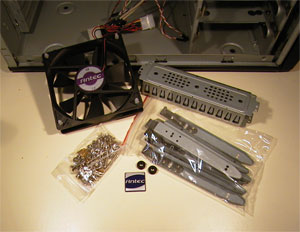

The case ships with a large assortment of screws and standoffs, 8 drive rails for mounting CD/DVD drives, 2 EMI shields, a case badge, some extra rubber grommets and the 120mm 38.94CFM 24.86dB ball bearing fan. The supplied fan intended to be installed in the rear fan mounts, and is fitted with the same soft bendy rubber clips that Agg noticed on the P160. To mount the fan, squeeze the clips through the mounting holes, and trim the ends if you want it to look a little neater. The soft rubber clips will then isolate the fan from the chassis, to reduce any noise or vibration. I did not trim the rubber clips as suggested in the manual, and I hope that with some care, the clips will allow the fan to be removed or repositioned as required when changing the internal or cooling components.
