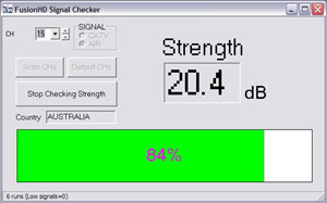

Fusion Signal Checker:
Handy dandy signal checker! No.. really! It's great! Let it scan around for channels, and then tell it to check the strength, it will tell you exactly how strong a signal is. Not really much to explain, but its good for testing, seeing of one configuration of cable results in a better signal or not. The graph updates every second and you can select each of the channels that are pre-saved by the main program, or it can scan itself.

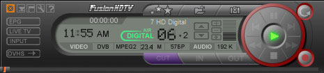

Fire up FusionHDTV!
On startup, if it pops up and warns that it cannot connect to overlay mixer, close any programs such as media player or explorer windows that are previewing a movie, and start FusionHDTV again.
FusionHDTV main window
When you start it for the first time, it asks if you would like to scan for channels now, if you want to watch tv, click yes, otherwise, click no and stare at a black box until you're ready. :) The auto scan window plods through and scans for channels. It should detect at least 5 streams:
