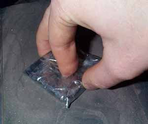

Hold the cpu slug-down (derr) with your thumb and middle finger each on a side. Press down on the middle of the bottom of the CPU with your index finger (between the pins):

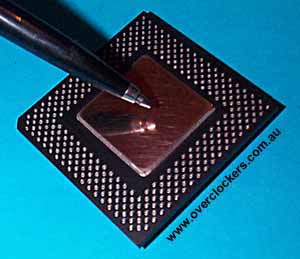

When you have a lovely polished flat surface, carefully blow or vacuum away all the dust and metal shavings and cut the tape and staticbag away from the cpu. It's easiest if you cut along the sides of the cpu casing and pull the bag apart that way. Vacuum and clean the cpu properly with a tissue, clean your hands thoroughly and clean up your work area. You may want to rinse the sandpaper off so you can use it again - I use wet/dry sandpaper so I just take the whole glass sheet into the shower and rub it almost clean. Now stand back and admire your masterpeice!
mirror mirror on the slug
Now - was it all worth it? In my experience yes - every one of the 6 C366's I've sanded to full copper have shown a drop in temperature - usually 1 or 2 degrees C. This can be all the difference between stability and crashes when you're on the edge. It makes a much more marked difference if you're looking into active cooling - my 2 best C366's would lock up just after loading W98 at 616MHz with a 40W peltier on them - they run well enough to install Sandra and run a few benchmarks now. They'll even let me play about 10 minutes of Sports Car GT! Click here for the full Peltier Experiment story.
