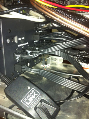

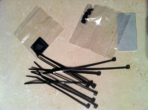

Very small zip ties, smaller screws and tape to hold down the Corsair Dongle (not that the manual said that).
Click to Enlarge
Final cables plugged in.

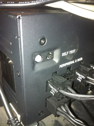

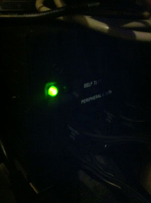

I was stupid enough to try and press the self test button with the PC off (nothing happened).
Click to Enlarge
When I booted the system the self test light went green.
Click to Enlarge

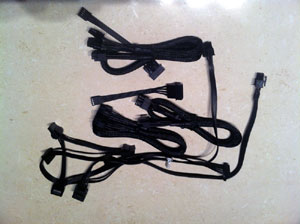

These are the cables I had spare.
Click to Enlarge

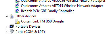

I then quickly went here to get the Corsair Link driver software. The page listed software for the 1200W but not the 860w PSU. I installed the Link SW and then fired up the Corsair Link Software. The Software did not lock onto the sensors inside the PSU.
Click to Enlarge
I then detected that the drivers were not installing automatically.
Click to Enlarge
A quick force of the driver install was in order.
Click to Enlarge
Still no luck talking to the PSU, ok time for a reboot.

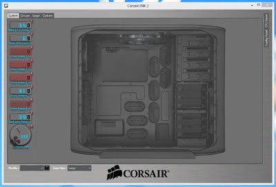

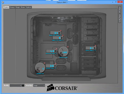

A reboot worked the Corsair software started showing values. I could not see my PSU temp and fan speed, Geforce temp and fan speed, CPU temp and only 1 drive temp (not the other 4).
Click to Enlarge

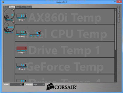

A table of these temps could be seen but was not very informative.
Click to Enlarge

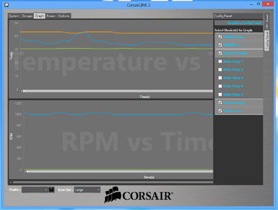

The graph tab showed the PSU’s temp and fan speed history.
Click to Enlarge

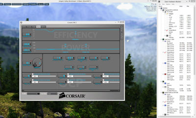

The Power tab is the impressive one, it shows the PSU’s incoming power draw from the wall and outgoing power after conversion. I noticed that my system was pulling 60w from the wall and sending 59w to the idle system (99% efficient) WOW. I could even change the PSU from a single rail 12V to a multi rail 12v if I wanted to. I still cannot get over how quiet the PSU/system is now.

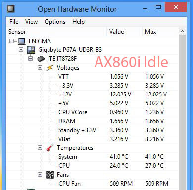

I checked the idle voltage readings again and the 12v and 5v are almost bang on. The 3.3v is 3.285v (a little low bit OK???).

I loaded up the same Unigine Valley Benchmark 1.0 and a few background processes to get a busy voltage reading and the voltages were very acceptable (less drop than the old PSU). The PSU was drawing in 250w and was outputting 248w of power. The PSUs fan did not even bother turning on.
