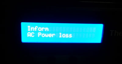

First up, the UPS, which of course stands for "Uninterruptible Power Supply". In short, a battery will keep the unit running for a short time if the mains power goes down. This definitely sets the Thecus N5810PRO above most other NASs I've seen. As for testing this feature, well, there's no rocket science here. The unit had been turned on for a while and was idle. I pulled out the power cord. Nothing happened for about 5 seconds, and then it beeped and the front LCD screen lit up with "INFORM: AC Power Loss".
Click to Enlarge
I waited a few more seconds and then plugged the cord back in. The screen went back to displaying the normal status info. Hrrm. I pulled the cord out and left it out. More beeping. I felt like a murderer in a hospital. I browsed the shared folder and played videos from the NAS while it kept beeping. This worked for several minutes, then the beeping stopped and I suddenly couldn't browse the unit any more. It was still on, though. The beeping continued and after another minute or so it cleanly shut itself down. So the UPS doesn't get you a lot of time to continue using the NAS, but it means the unit will cope with a short blackout, and can cleanly shutdown in the event of a longer one.

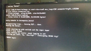

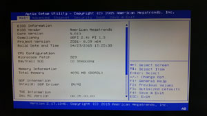

Also of interest is the HDMI connectivity. I connected an HDMI cord to the port and a monitor and powered up the unit. This resulted in a somewhat minimalist Linux boot info screen and login prompt. But before that, an AMI BIOS screen. Hrrm. Time to plug in a keyboard. Rebooting and pounding the DEL key resulted in a BIOS setup utility like you'd expect from any PC. It seems to have Windows support and you can boot from the USB stick, so who knows, you might even be able to install Windows on it if you felt like it. But certainly there's another level of configuration available via the BIOS if you need.
Also, logging in at the Linux boot screen as "root" with password "admin" gave me a standard bash prompt with nice terminal colours, useful tools like "top" and the ability to view the network shares through the filesystem. So if your Linux-fu is strong, I imagine there's pretty much no end to what you could get up to with this machine. Maybe change the root password as a first step.

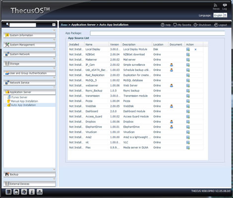

But let's not get too carried away. Back to the HDMI port. You can install packages via the web console to enable local media output. These "App Packages" can be installed via a file you download from a library on Thecus's website, or there are some in a pre-configured list on the unit which are ready to be installed with the click of a mouse.
Click to Enlarge
If we install "LocalDisplay" and "HomeMedia", that should turn this NAS into a media player. I had to find this out by Googling as the manual doesn't go into this side of things in much detail and there really isn't any kind of useful description of the apps apart from their names. Eventually I found this PDF which is useful. Incidentally, installing these packages while having "top" open on the Linux console is interesting, as you can see it using wget and unzip etc to install it just like any other Linux package.

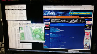

Once the two modules are installed, you can start them via the web console - slightly counter-intuitively, this is done via the "Manual App Installation" screen, after they have been installed via the "Auto App Installation" system. Starting LocalDisplay boots up a Linux desktop manager with a few preinstalled apps, such as SMPlayer and Firefox. This seems to be "icewm" but I imagine you can set up another instead.
Click to Enlarge

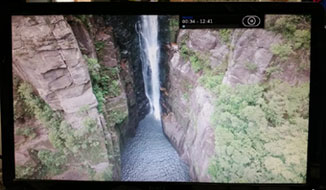

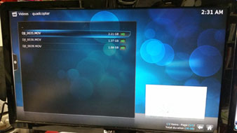

Starting HomeMedia gives you XBMC, a very popular media player and library manager. Within minutes I was playing HD videos direct from the unit, using a mouse plugged into one of the back USB ports. It seemed to play back normal .MKV movie files at 720p fine, and even a high-detail .MOV video at 1080p didn't seem to trouble it too much. I didn't experiment with the audio but it can output via HDMI or the Line-Out jack. So it seems like a pretty capable media player, if you want to have it next to your TV or projector.
