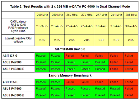

Our next objective was to find out how the A-DATA PC 4000 modules are working in dual channel mode. For this test we selected the 2 modules with the highest overclocking headroom.

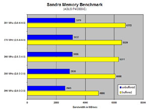

Table 2 shows that these 2 handpicked modules passed Memtest-86 up to 277 MHz. They completed the Sandra memory benchmark up to 281 MHz at 3-4-4-5 and 2.85 volt. Finally we had a look at the bandwidth using our ASUS P4P800-E sample because this board is known to have one of the best bandwidth outputs among 875P boards. At 200 MHz and running at CL 2.0-3-3-5 the P4P800-E produced a buffered bandwidth of 4900 MB/sec and an unbuffered bandwidth (SSE optimizations disabled) at around 2600 MB/sec. This is not very impressive and clearly the result of the “soft” memory timings. RAS to CAS (tRCD) and RAS Precharge (tRP) are driving bandwidth at 865/875 boards. In our tests, A-DATA 4000 allowed both parameters to run only at 3 clocks. This even when the memory was running at 200 MHz which is far below the advertised default frequency of 250 MHz. A-DATA PC 4000 makes a strong point though when it is running at high frequencies and in a particular of course when it is running at frequencies where other RAM modules would have given up much earlier. We finally arrived at around 3300 MB/sec unbuffered and almost 6800 MB/sec buffered bandwidth at 281 MHz. That is of course a mighty punch. Whether such high bandwidth is really necessary or beneficial for contemporary games and applications is another question. But it is certainly fun to run memory at such extreme frequencies.
Click to Enlarge Click to Enlarge
250MHz buffered (left) and unbuffered (right)
270MHz buffered (left) and unbuffered (right)
281MHz buffered (left) and unbuffered (right)
