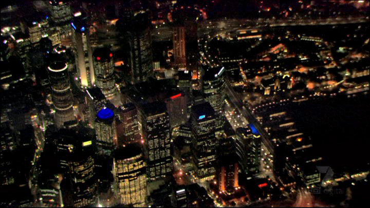

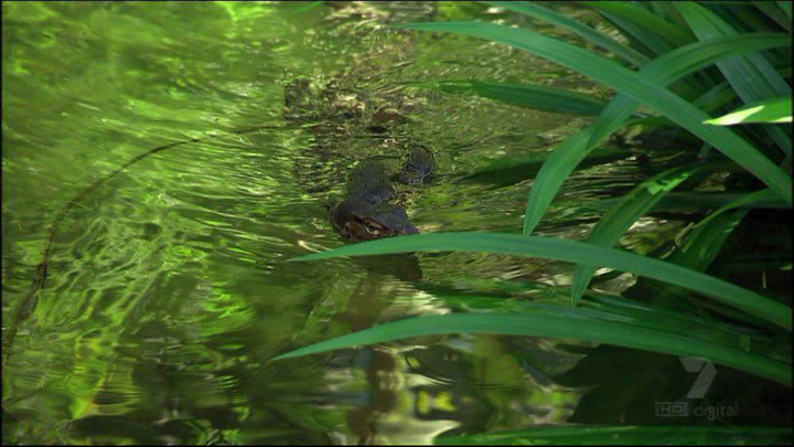

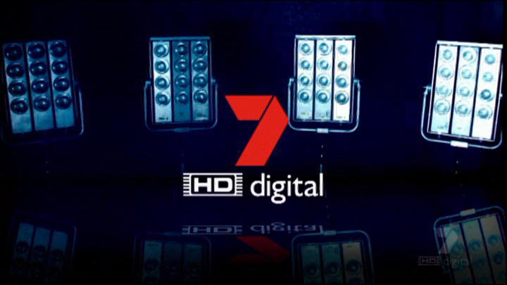

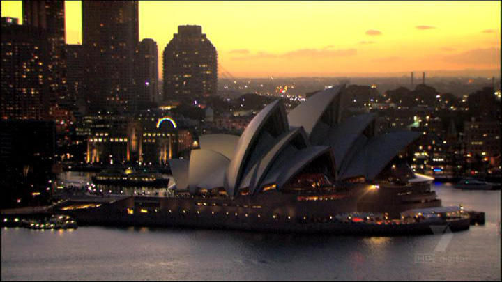

These images are jpeg captures of the Channel 7 HD Demo loop, they are 576p with 192Kbit Mpeg 2 audio. The images have been resized to 720x405 from 720x576 to correct for pixel aspect ratio :)

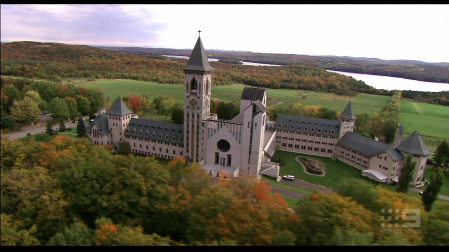

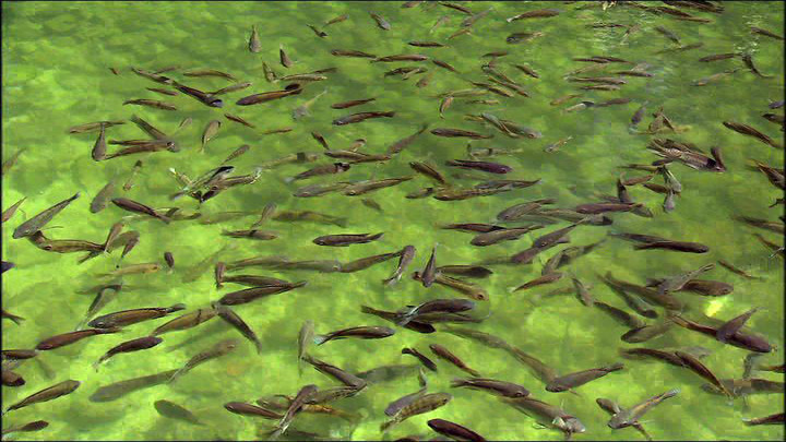

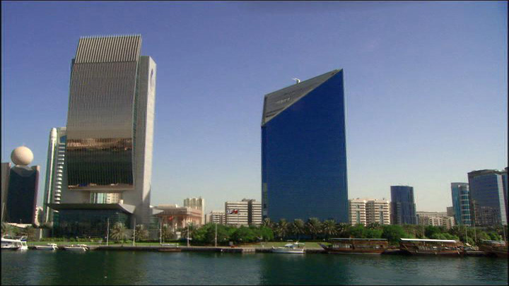

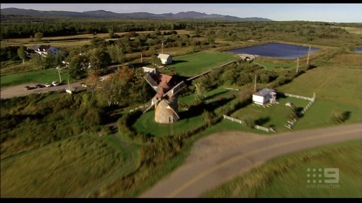

These images are jpeg captures of the Channel 9 HD Demo loop, they are 1080i with Dolby Digital 5.1 Audio. The images have been resized to 1440x810 from 1440x1080 interlaced to correct for pixel aspect ratio :)

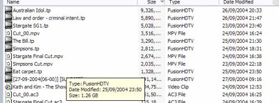

After it's recorded, you can pop down to the directory you set to download to, and open up the files. Usually you'll be greeted by these happy characters.
Click to Enlarge
Better hope you're running NTFS!
File Sizes:
1 hour of HDTV is quoted as about 9.3GB of disk space in the manual and that's pretty spot on. SD takes up about 4GB to the hour, depending on the bitrate and how bad your connection is (ie. how much of the signal you miss due to interference.) Note that all the oldskool FAT32 users are going to be up the creek here; NTFS will give you 1 9GB file, whereas FAT32 will give you 9 1GB files, tidy! Transcoding the files through the FusionHDTV converter utility is easy enough for most people, however it does not yield optimum quality for DivX as it's only a single pass, I like to do up to 4 passes on DivX5 Pro to get the most out of every bit. For encoding to a DVD it's adequate. The retail package comes with Videostudio 7 SE DVD, I'm not going to review that, I'm sure someone else has.
