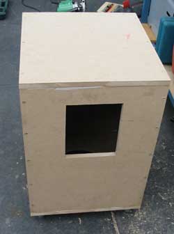

At this point I advise sanding the whole thing back if you want a neat finish. This is the completed box ready for hardware. You can paint it or whatever you like at this stage too.
Now I'm going to put my rubber feet on it and take it inside to do the rest because the weather's looking foul!

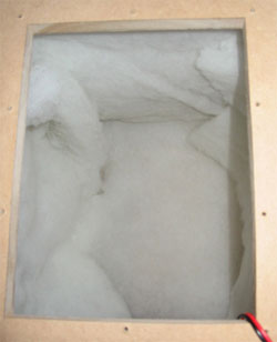

Now I'm inside I'll stuff it full of deadening batts. You can staple or whatever this to the walls if you like. I just put a few screws on the inside of the case, pulled the batts over it and then bent the screws (how slack eh!)

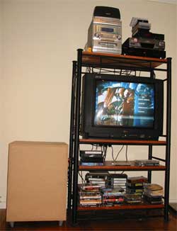

Here's the finished Subwoofer standing next to my crappy Pro Logic system. The TV is a 72 cm job to give you an idea of size.
