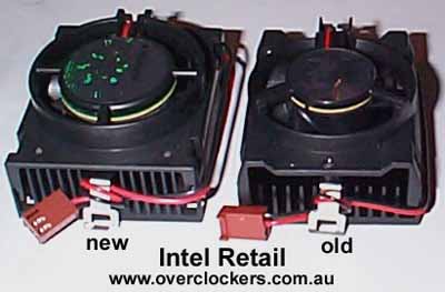

Actually, there seem to be at least 2 different units included with the retail Celeron PPGA 366A's. See the photos below.

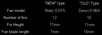

The "old" type came with the first batch of 366's we got, week 14's. The "new" type came with some week 15's and 17's we got a bit later. We don't know if there's actually a time correlation between them, but we're going to call them "old" and "new" to differentiate them. Here's a quick summary of differences we spotted:
As these are obviously very different units we thought we'd see how they compare performance-wise. Unfortunately neither provide the capability to monitor the fan's RPM so we couldn't see if they differ there. Another problem with the retail units is that the cable is very short. It's long enough to get to the nearest fan connector on the Aopen AX6BC-Pro, but not long enough to get to the other one. This may be a problem as some people don't like using the "smart" connectors as wayward software can sometimes turn the fan off. If you have a peltier on your system this can be catastrophic.. (but then again - if you're using a peltier with the retail heatsink/fan you deserve everything you get :) )

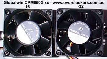

This unit has formed the backbone of our overclocked C366 business. A solid performer, it has been recently superceded by the CPM25603-32 (which used to be called the CPM25603-12 but was renamed). It uses the Superred CHA6012DB-A fan, which moves 20cfm.
Globalwin CPM25603-32:
This unit sports the same 25mm-high heatsink as the -16 unit, but boasts a newer, more powerful fan (a YS-Tech FD1260257B-2A 2.16W unit pushing 26cfm). Although it spins slower, the new fan actually pumps more air (and is noisier).
You can see the differences below. The -32's fan has much more aggressively angled blades.
