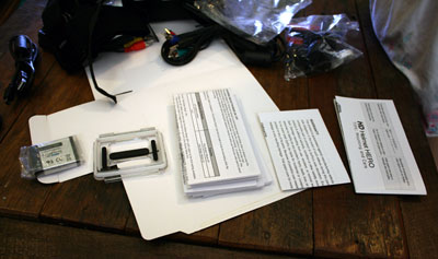

Opening up the first bag we find the tiny Li-Ion battery (1100mAh, 3.7V), a non-waterproof spare housing back panel, manuals in various languages, a warranty sheet and a mounting/care tips sheet. I actually found the instructions a little lacking. Don't get me wrong, I got up to speed quickly enough and the menus etc are all explained, but there's no real "start here" or quickstart type guide. It's also not made super clear how to open the housing, or remove the back panel of the housing, etc. Still, I worked it all out eventually.

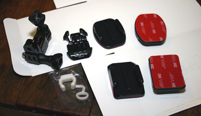

Moving on to the bag of connectors included with this kit, we have a three-way adjustable pivot/extension arm, a mounting clip (2 included), then the adhesive bases that the clip clips onto, and a mysterious white rubbery object. The top two adhesive bases are the same, with round corners and flat in profile - I just turned one over to show the adhesive pad beneath. Ditto the square-corner ones, but these are curved to attach to curved surfaces more easily. The adhesive pad has some give in it, so you don't have to perfectly match the curve, but it'll work better than a flat one. Speaking of flat, there's a large flat base thing used to hold the camera in the display case, which can be quite handy as a desk mount.
The adhesive in question is 3M's VHB, specifically VHB Tape 4991, which is an all-purpose outdoor adhesive. Note: this is an extremely strong adhesive. Pretty much, once it's on, it's on for good. I had one of these mounts stuck to the front of my old van, and when I sold the van recently, I tried to remove the mount, but gave up when it started to look like I couldn't get the mount off without damaging the van's paint. I imagine you could try a solvent and a hair dryer or something extreme if you're really keen, but again that won't be great for the mount itself, the adhesive, or whatever you've stuck it to. But you get a few in the pack and replacements aren't too costly.
Click to Enlarge
Here's a closer look at one of the round-cornered, flat mounts. The corresponding clip fits into the mount very snugly, like a harness clip, and from there you attach the extension arm or the camera itself. Long finger-turnable screws secure the various joints and they have multiple prongs meshing together for maximum friction, to avoid the camera moving or falling off during use. You can use a large-ish Philips-head screwdriver to really tighten them up if you're paranoid.
Speaking of which, the mysterious white rubbery object (orange in some kits, apparently) was, as you may have guessed, something of a mystery at first. It's not mentioned in the instructions, but a quick Google reveals it fits into the clip mechanism once the camera is clipped in. This might be simply additional reassurance that the clip won't unclip under extreme load (because the rubber thing is in the way) or it might be to do with sound dampening. I haven't tested recording with it in place yet, but I'm keen to see if it eliminates the occasional rattle I heard from the housing in some recordings.
