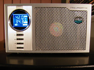

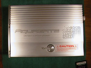

The Liquid Cooling Unit or LCU is the heart of the AquaGate system. The LCU contains the pump, radiator, reservoir and cooling fan, all neatly enclosed in an attractive looking brushed aluminium and chrome steel enclosure. The LCU measures about 147x85x205mm and is designed to be used in one of three mounting configurations: externally, internally in drive bays or internally in a PSU space.
Click to Enlarge
The LCU can be run as an external unit. The included tubing allows the LCU to be positioned anywhere within about a meter of the PC and the water pipes are easily routed out the back of the chassis using the included PCI bracket. The default configuration incorporates the LCD module as part of the LCU unit and a D-bus cable connects from the PCI card to the back of the LCU. An external AC power cord is also required to power the pump.
Perhaps the most logical home for the Liquid Cooling Unit is to mount it internally in two 5.25" drive bays. This configuration allows all the components to be kept inside the system, creating a much neater looking setup. The water pipes can be cut to a short length, the external pump power cable routed through the back of the PCI bracket, and the D-bus cable connected to the internal port on the PCI card.
The LCU can be also mounted internally into a redundant power supply mount (using the included bracket) if you happen to have a large tower case that has an second PSU mount. CoolerMaster's own Stacker case, recently announced, has an extra PSU space at the bottom which would presumably accomodate the LCU. The LCD control panel can be removed from the LCU and mounted in a spare 5.25” drive bay so you can see it while the LCU is mounted in a PSU space at the rear of the case.
Click to Enlarge
The LCU and incorporated LCD module mounted externally on the top the case; this was the configuration for most of our tests.
The LCD module also has 4 push-button function controls. The bottom button changes the display between degrees Celsius or degrees Fahrenheit, the top button changes the function selected and the middle two buttons are ‘up’ and ‘down’. The function button allows four adjustable settings to be changed; Set temperature (for both the CPU and water reservoir), fan speed and shut down time. The shut down time allows you to specify how long the AquaGate will wait before turning the system off - via the power on/off motherboard header - in the case of an emergency. The default shutdown time is 30 seconds, but can be varied between 0 and 100 in 5 second intervals.
