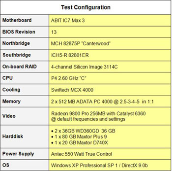

After we found the e.SATA RAID Kit working as advertised we finally wanted to see how the kit is performing in comparison with other SATA RAID solutions. For this purpose we compared it with Intel’s Southbridge integrated RAID solution and Silicon Images’ SiI 3114 4-channel RAID controller.
Click to Enlarge   Click to Enlarge   Click to Enlarge
Intel’s ICH5-R was the first Southbridge implemented on desktop mainboards offering integrated RAID. Functionality however is limited to RAID 0 and RAID 1. RAID 0 (striping) does not offer fault tolerance and RAID 1 (mirroring) does not offer the performance advantage most desktop users have in mind when they set up a RAID system. The 2-channel Silicon Image SATA 3112 chipset is a very popular on-board solution implemented on many newer mainboards. Its bigger brother, the 4-channel SiI 3114 chipset we are using for this test, is currently only available on ABIT’s Max 3 motherboard. We have recently tested this mainboard here with good results and are using it again for this comparison. Below we show the RR1542 installed in the Max 3.

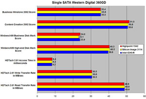

In our first test we compared Highpoint’s RR 1542 with Intel’s ICH5-R and the Silicon Image 3114 controller using a single Western Digital WD 360GD “Raptor” hard disk. We used the HDTach 2.61 hard disk benchmarking utility to take sequential read/write transfer rates and the disk access time. We then tested the Raptor with applications that are usual for a desktop environment. Unfortunately there is only the rather dated Winbench 99 test program currently available for application based HDD benchmarking. WB99 is running a collection of high-end desktop applications. They are “I/O bound” scripted in such a way that they are intensively reading and writing from and to the disk, by this they are “magnifying” performance differences between hard disk. WB99 comprises among others 2 benchmarking test sets, one representing a business environment and the other one a high-end desktop environment. In addition we ran Content Creation 2002 and Business Winstone 2002. They as well are simulating PC usage with business and content creating applications such a Lotus Notes, various MS Office applications, FrontPage, Photoshop, and various video and audio editing applications. The later 2 programs are measuring “system performance” and do not emphasise hard disk performance as WB 99 does. The test results show that all 3 competitors deliver almost identical performance. Differences between transfer rates, access time, and application performance basically do not exist.

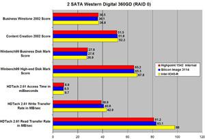

In our second test run we used 2 Western Digital WD360GD in RAID 0. Again we can see that there is basically no performance difference between the Highpoint, Silicon Image and Intel RAID solutions. It is obvious that the PCI bus, although limited to only 132 MB/sec maximum bandwidth has no problem to handle a 2-disk RAID 0 array. As already speculated above the actual transfer rates with a 2-disk RAID 0 are far below the theoretical maximum of 2 x150 MB/sec with 2 SATA disks and obviously well within the capacity of the PCI bus. The RAID 0 performance with the 2 PCI based RAID adaptors is therefore not worse than with the ICH5-R which has a much higher theoretical maximum bandwidth (ICH to MCH) of 266 MB/sec.

Left to Right above: 2x WD360GD in RAID 0 on ICH5-R, SiL3114 and RocketRaid1542
